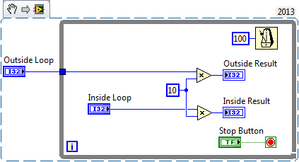

Gerd's point was that your code on the host will not have any effect on the pulse generated because the controls are outside the while loop on the FPGA.
Consider the following: what happens to the results during execution of this VI if you change Outside Loop and Inside Loop?
CLA
(6,720 Views)
Ahhh, yes that makes more sense. Does this mean that you cannot pass the output data from the calculation into the sequnce structure to control the timing as well?
(6,706 Views)
If it's outside the loop and wired in, the loop will use the value on first iteration and won't see any new values.
CLA
