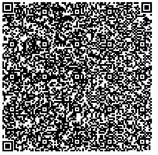

hello darin
your program is very useful. thank you for this
despite of this, I have noticed a kind of bug: when the qrcode is big (version>around 17), sometimes, depending on the data, the QR is not detected.
the more I increase the correction error level, the more often there is unreadables qrcode.
take a look in the picture joined. this QR has been done with version 21 and correction Q (but unreadable qrcodes appear also at level 16 and correction L)
