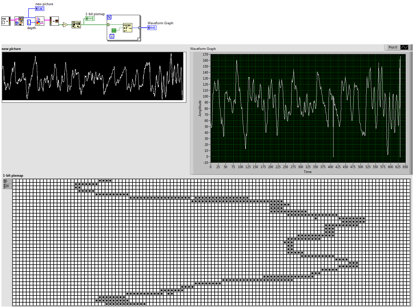

Oh, shoot. I thought I posted a snippet. I deleted the source.
First, I cropped the png file to the smallest area that included the white line. I used gimp2, but paint works just as well.
Then, I loaded the png file, converted it to a 1-bit pixmap, rotated it 90 degrees (transpose 2d array), and saved the index of the first True value in each row.

hello,
we have a trouble in connecting source to sink since the type of the source is different from the sink.
the type of the source is double(64 bit real(~15 digit precision))
the type of the sink is 1D array of double(64 bit real(~15 digit precision))
plz help us to rectify it

Hi Todd_Lesher,
I tried the way you explained but I am not getting of how to rotate 90 degrees and I need some modification to get the final as yours.Can you help me out in modifying the attached as the same of yours.

Patan,
Think these are just basics.
You already used the functions of the most uncommon blocks.
Anyway I added it in attachments, you could just use the snippet from Todd.

Hi KoenR94,
The vi you posted is reading the PNG image but it is not showing up the final waveform.The input image I fed is attached below.
Can I know what is the problem with this.
