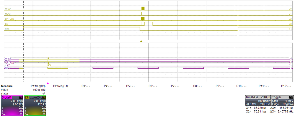

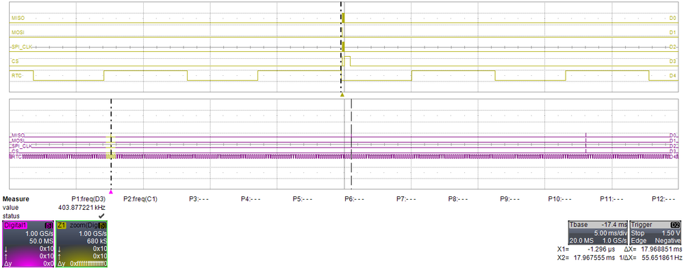

I created a .HWS file using Digital Waveform Editor and used SignalExpress to send this signal on every falling edge of the PFI 0 input through the Trigger Tab. Unfortunately, the SPI signal is only send every 116 falling edge.

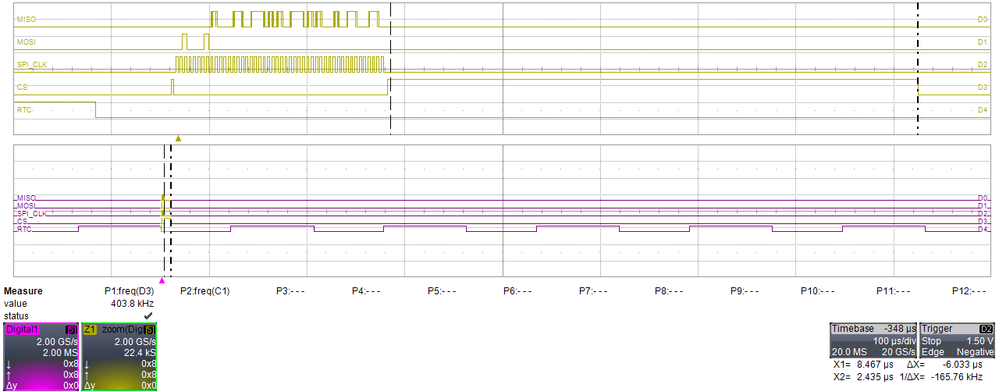

I have tried changing parameters here and there, but just can't seem to have it work ! Here is what I am observing. (MOSI, SPI_CLK and CS are generated by the HSDIO module, RTC is what's connected on PFI 0 and MISO is generated by the FPGA).
I have tried doing the same thing on Labview using NI-HSDIO Express (Generation) and observed the same behavior...
Do you have any idea of what I'm doing wrong? Please find pictures of my code attached as well as the .HWS file.
I am also curious as to why the CS remains high for a few us but that is a different problem.

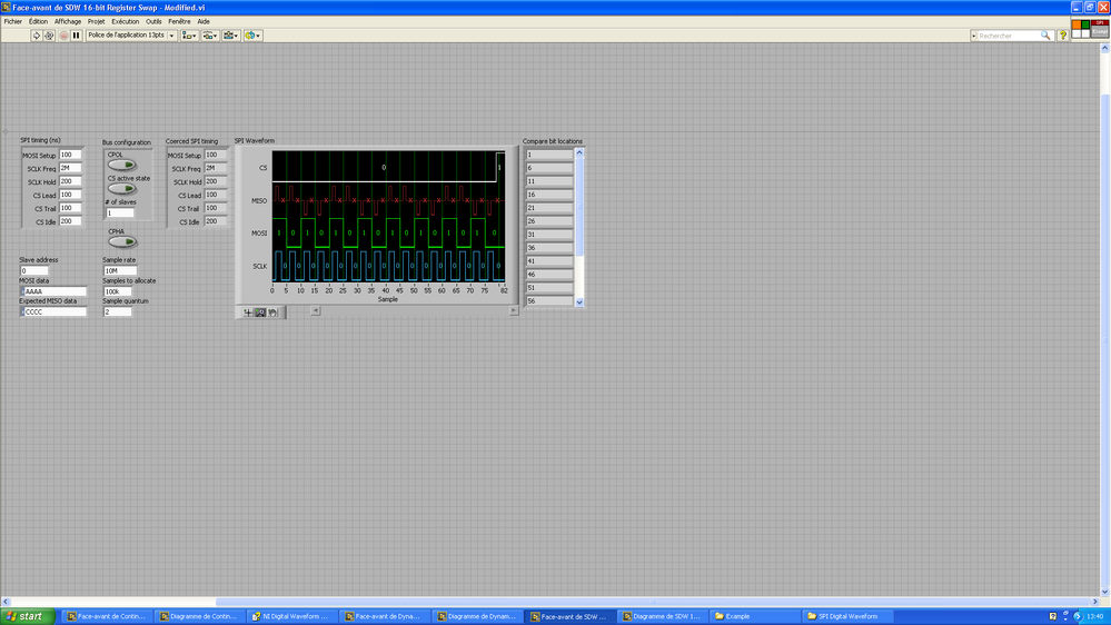

1) 16-bit Register Swap
The example you linked uses the example "16-bit Register Swap" to create a Waveform that is later generated by the HSDIO Module.
By default, these were the values assigned to the front panel of the "16-bit Register Swap" example:
16-bit Register Swap front panel with default values16-bit Register Swap front panel with default values

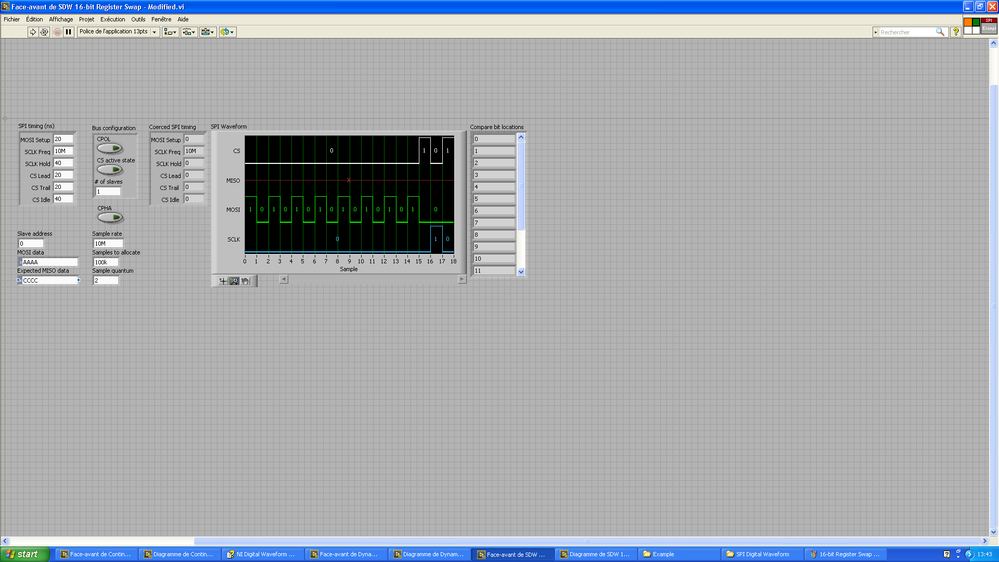

My SPI_CLK should be set to 10MHz so I changed the parameters as shown below:
16-bit Register Swap front panel with 10MHz values16-bit Register Swap front panel with 10MHz values
As you can see, the waveform is not what's expected... I tried tuning up the different parameters but wasn't able to obtain any satisfactory result 😞

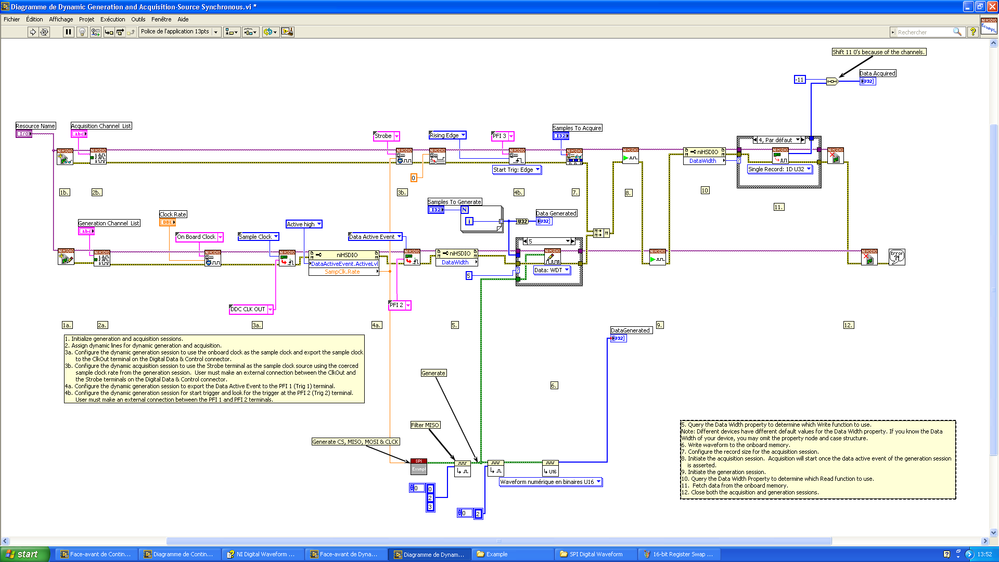

2) Dynamic Generation and Acquisition
Here is the code of that example:
Dynamic Generation and Acquisition - CodeDynamic Generation and Acquisition - Code

I also don't fully understand how these .vi work:
3-1) niHSDIO Configure Sample Clock.vi:
What's the "clock rate" input for? It’s set to 10MHz by default but that doesn't seem to affect the SPI signals.
3-2) niHSDIO Export Signal.vi:
What's the "signal (sample clock)" input for? It is set to "Sample Clock" but I have no idea of what that implies.
3-3) niHSDIO Export Signal:
The "Signal (sample clock)" input is set to "Active High" and the "output terminal" is set to "PFI2". Is that why PFI2 is observed to be at high state when SPI signals are sent?
3-4) niHSDIO Configure Digital Edge Start Trigger:
Similarly, I thought this function would start on PFI3 rising edge. However, it seems this function is executed before niHSDIO Initiate.vi (which physically generate the SPI signals), hence before PFI3 could trig!
4) Improvement of Dynamic Generation and Acquisition:
I tried to make some change to "Dynamic Generation and Acquisition" so that more than one SPI buffer would be sent. I tried to duplicate the niHSDIO Initiate.vi function and I did observe 2 SPI buffer, but why is there a 800us gap?
Dynamic Generation and Acquisition - niHSDIO Initiate.vi  duplicatedDynamic Generation and Acquisition - niHSDIO Initiate.vi duplicated
I'm sure I could avoid that gap by generating a single larger waveform, but that wouldn't be scalable. (My goal being to setup a continuous, uninterrupted acquisition for long durations)
Any answer to any of these questions would be welcomed. (Let me just remind you I'm new to Labview)
Thanks a lot in advance for your help,
Hugues
(3,911 Views)

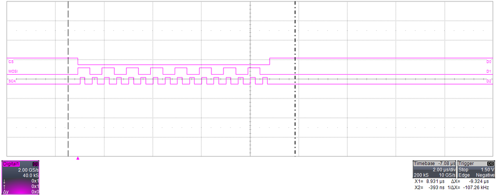

1) Single synchronized generation and acquisition:
See folder "Looped synchronized generation" in .zip file.
Dynamic Generation Hardware Start Trigger Modified.vi generates and acquires SPI signals (which originate from a .HWS file) once on a falling edge of PFI0.
Here is my Pinout:
  • Pin 1: MOSI -> wired to ASIC
  • Pin 2: SPI_CLK -> wired to ASIC
  • Pin 3: CS (active low) -> wired to ASIC
  • Pin 16: Wired to a GBF (not used in all pictures)
  • Pin 22: MISO -> wired from ASIC
The .VI is working as intended as shown on Single synchronized generation and acquisition - Oscilloscope.png and Single synchronized generation and acquisition - Front Panel.png.
MOSI, SPI_CLK and CS are generated by the HSDIO PXI-6541 module. The ASIC answers on MISO. The signals appear on the Oscilloscope and on LabVIEW.

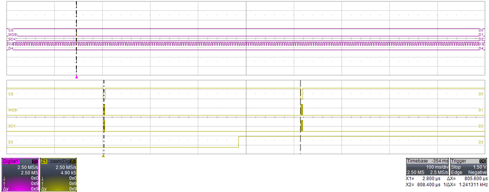

I tried to loop 1) in 3 different manners:
2.1) Looped synchronized generation and acquisition - TEST 1:
See folder "Looped synchronized generation and acquisition - TEST 1" in .zip file.
This doesn't work, the SPI signal is only sent once on the first falling edge as shown on Looped synchronized generation and acquisition - TEST 1 - Oscilloscope.png.
2.2) Looped synchronized generation and acquisition - TEST 2:
See folder "Looped synchronized generation and acquisition - TEST 2" in .zip file.
This partially works. SPI signals are generated on some but not all falling edges of PFI0. The generation/acquisition frequency is around 600Hz as shown on Looped synchronized generation and acquisition - TEST 2 - Oscilloscope.png.
2.3) Looped synchronized generation and acquisition - TEST 3:
See folder "Looped synchronized generation and acquisition - TEST 3" in .zip file.
This partially works. SPI signals are generated on some but not all falling edges of PFI0. The maximum generation/acquisition frequency is around 1.3kHz as shown on Looped synchronized generation and acquisition - TEST 3 - Oscilloscope.png.
Note: I haven't managed to display the data but I'm assuming the data was acquired properly.
