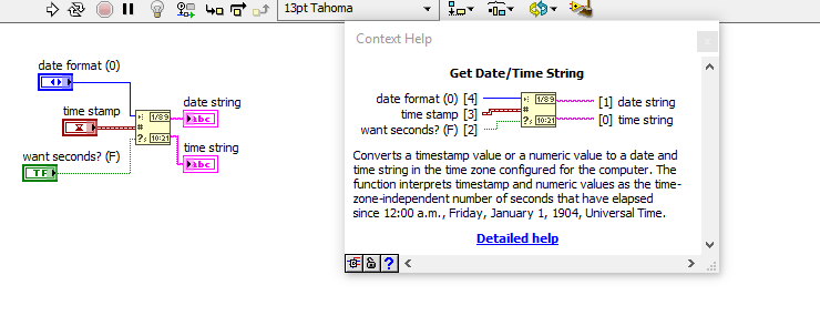

Is there something corrupt in your LabVIEW installation?
On mine, that isn't an integer, but a timestamp.
 Capture
EDIT:  Perhaps nothing is corrupt in your LabVIEW installation.  That might be a polymorphic function.  When I wired an integer into that same terminal, it connected without a coercion dot and the context help changed to look like you have it with a blue wire going in.
I have not touched NXG at all.  But have you tried to wire in your integer into the function it provides?  At the end of the day, the function is looking for a number that represents seconds since the epoch.  If your integer can't wire directly to the existing function without error, perhaps you can adapt the date from an integer to whatever the function will take?

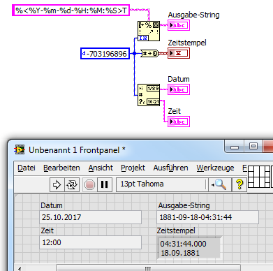

the problem is with just that specific function:
(image taken from LV2011)
I do prefer FormatIntoString most of the time (for any kind of string handling)…

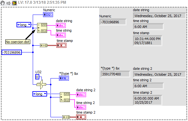

I think it is more than an inconsistency.   Possibly a bug on the integer version of Get Date/Time String in traditional LabVIEW.  (See the attached snippet.)
There is a defined behavior for negative values in timestamps.  It is that they reflect the number of seconds BEFORE the epoch.  The NXG version of Date/Time record is handling that.  The NXG version of Get Date/Time String seems to be coercing it to 0, and thus the epoch.
Classic LabVIEW with a negative value going into a timestamp indicator is giving the same date time as the NXG date/time record.  But the negative value going into Get Date/Time string is being typecast into a U32 then that being given out a string.  (So 2's complement of -703196896 is 3591770400.)   There is no coercion dot happening on that input indicating that anything different is happening.
