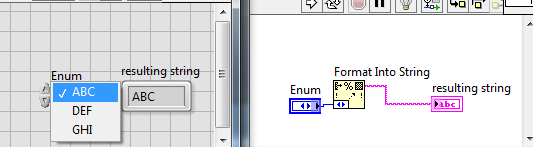

Mangesh D thanks for the reply although my problem was to do with getting the string from a variant rather than a simple enum control
