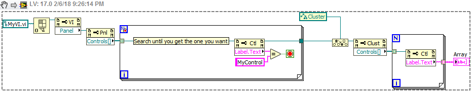

Open a reference to another VI, get the references to the controls in that VI, figure out whatever scheme gets you specifically the control you want, and pass that reference into the property node.

You don't need to pass in a reference.  As I said before, you can open a reference to a VI and get the reference to the control from that.
