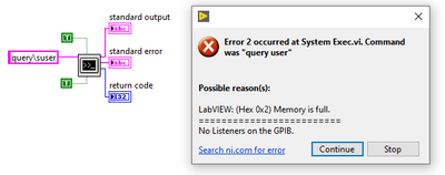

Here is the error when I try that.
I am guessing the memory full error is somewhat generic because this machine has 64GB of RAM and is nowhere near full. Not sure what the No Listeners on GPIB is. Searching the error has not been very helpful.

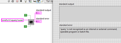

I followed the steps in this article:
LabVIEW: (Hex 0x2) Memory is Full When Using the System Exec VI - NI
When making the command "cmd /c query user" it seems to be working now, but only that it returns the error stating query is not a recognized command, same as typing it manually into the console opened by System Exec vi.
