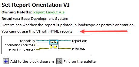

How can I set the oreintation of HTML report while printing it ?
The set orientation vi of report generation toolkit is not working with HTML format.

HTML "Reports" have no "orientation" (think about it -- they are meant to "adapt" to the screen size).  This is from the LabVIEW "Help" --
