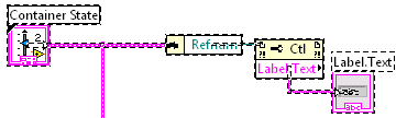

So you want a self-aware XControl?
This will do it.  Take the refnum in your "Container State" and do the following
Shane.
(3,843 Views)
Hi Intaris,
Perfect!
Thank you very much.
