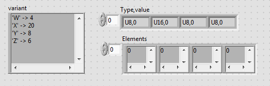

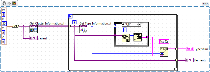

I am trying to get a cluster element value from its variant form
If I look at the variant indicator, the elements and their values are displayed. However, after Get Cluster Information.vi, which I expect to break up the cluster into its individual elements, all I get is the type information, not the value of the element. That is, looking at the Elements array, all that is displayed are 0's, I was expecting values and element names.
So my question is, how do I get the cluster element values?

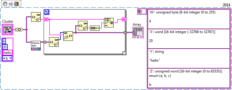

One of my pet peeves is that Flattened String to Variant function does provide the remainder string, but with a bit of ugliness it can be worked around.
Message 2 of 16
(13,195 Views)

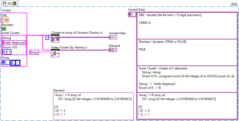

Autotestware Cluster Toolkit 2.0.0.4. You can granulate the 'Variant Data' output to your specificity with the 'Grains' input control. Or use Index Cluster (by Name).vi to return a single element.

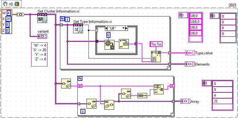

Thanks Darin,
Unfortunately, I am not able to duplicate your results with the Variant/Flatten kludge. Does the LV 2015 Get Cluster Information.vi differ from your LV 2014 Cluster Info VI?

To AutoTestWare,
Thanks for your reply, but I am trying to get a value from a cluster variant not create a variant from a cluster. I looked at your set of cluster tools and did not see one that accomplished this. It is a nice set of tools but not appropriate for this application.

@c_chip wrote:
Thanks Darin,
On a side note, why are variants treated like a secret shame? They are a fundamental part of LV and its only been recently that VIs to handle them were added to the official pallette. It seems to me that my application of them, getting the value from them, seems pretty basic yet the process seems like a kludge. Is there something fundamental in the background that prevents a native implementation of this?
You need to wire the original variant to the flatten function instead of the output of 'Get Cluster Information'.
Message 7 of 16
(13,149 Views)
Aargh! Of course. Thank you. It now works.
