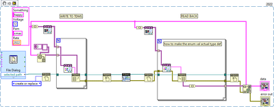

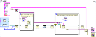

I try to write and read back TDMS properties that come originally from a cluster of settings of different types. I saw a solution incorporating xml that look promising.
Nevertheless I would like to figure out how to cast the type enum to an actual type, which get properties can handle. I know one could build a case structure with all accepted types but I am sure that there is a more convenient way to get this approach working.

The enum is a mapping between integers and strings e.g. 0-> invalid type, 0-> string, 1->U8 etc. Since the enum is from an official NI VI called Get Type Information.vi  it is reasonable to assume that labview, this expensive mature masterpiece, holds something built in, which maps this enum to the actual type. E.g. 0->Empty String Constant.

this is actually what I don't like. These Case Structures with types in it are not very readable. Since I had no luck importing the Scripting VI I elaborated further on this and came up with this working solution.
