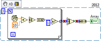

I thought this would be the easiest code to find out what values the array produced and pretty efficient at that:
I should mention that I don't have to cover a huge range of numbers - so wasting space by upconverting the numbers to powers of two isn't an issue.

It seems the OR array" function is polymorph (as written in the context help), but doesn't handle I32 arrays. Atleast the error message implies just that...
