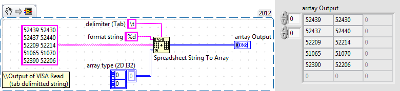

What other members are explaining to you, should look like this below snippet...
Read 2D array
Code (saved in LabVIEW version 2010) is attached.
