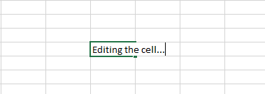

I have an application that runs tests then writes the data to Excel at the completion of each test. The problem is that the technicians use Excel to record what they did during their shift and if they are in the middle of editing a cell in Excel when a test completes, LabVIEW generates error -41112 when trying to create the output file. Here is the error description:
"Uncommitted changes appear in an active cell of an Excel worksheet. Select the cell and press the Enter key to commit all changes."
Just to be clear, this error only occurs when a cell is in the process of being edited as shown in the screenshot:
I'm writing some code that will check for this specific error when trying to write the output file and if it does, stop the cell from being edited and then retry the data output. The problem that I'm running into is that I cannot figure out a way to command Excel to stop the cell from being edited (esentially hit the ENTER key in Excel). There is a SendKeys method for the Excel Application through ActiveX, but I have not had success in using this method to send the ENTER key to Excel. Changing the active cell does not work either. Any suggestions?

That will not solve your problem but this is caused by the subVI NI_Excel.lvclass:new report subVI.vi where the Automation Open function uses the default value of false for the open new instance input.

I've been looking into this and haven't been able to find a workaround or anything for it after some research. I think what you're trying to do by have Excel move to a different cell and not be considered editing the cell might be the way to go. I'll see if I can dig up anything else.

Thanks Eden. I have used ActiveX to move which cell is active but it doesn't cancel the user's edit of the original cell. Let me know what you find. Also, say hi to Mr. Cunningham for me.
