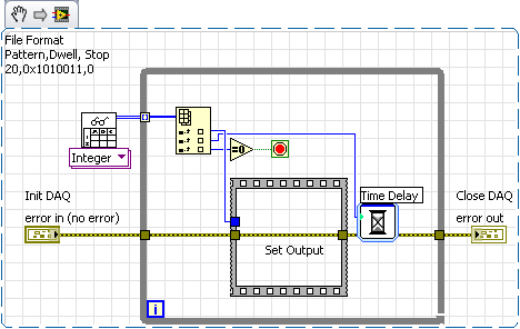

This snippet shows how to use the time delay express vi to get the type of operation I think you are looking for.
You say you have the DAQ code working so I left it out of my example.  You may also want to OR the Stop from the file with a boolean on the FP so you have control of the ecexution without relying on just the file.   Although you specifically stated you wanted to read the file for each "vector" its going to be much more effecient to read the whole file at once and auto-index the2D array.  However you could read a line at a time if your file is changing durring execution

Program.JPGThat's brilliant cheers Jeff.
I had to split the array twice and wired it up to the iteration count to make sure it kept looking at the next line but that's solved a lot of problems!!
I've attached a picture of my final program incase anyone else has the same problem.

There's no reason to use two separate DAQ Assistants. Set one for multiple channels.
(3,405 Views)
Glad to help!
I would recomend forcing some data depandancy by wiring error in and error out from your sub-vis but it looks like you got a good solution for your needs!
