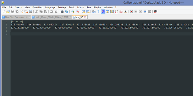

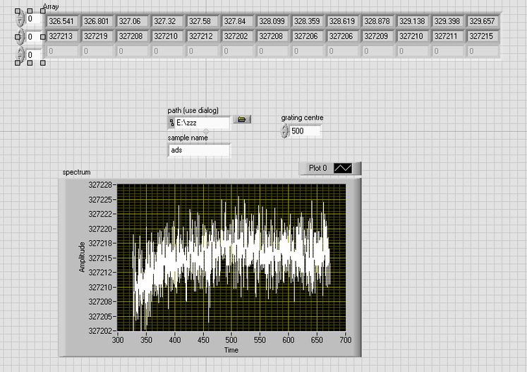

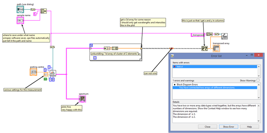

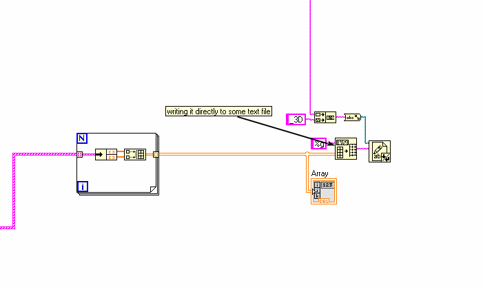

I am trying to export some data using the write to spreadsheet function. I get the spectra from a CCD camera using a VI I found in this post. That VI works perfectly, I can get the wavelength vs intensity plots on the front panel. The problem is, that the data comes in the form of "1D array of cluster of 2 elements" so I unbundle the clusters to get a 2D array which I could save as a spreadsheet but somehow I end up getting a 3D array. I have tried saving the 3D array into a text file as is and it only shows me the wavelengths and respective intensities. I reckon I might have caused lab view to just add an empty row as a 3rd dimension. I would highly appreciate it if you could help me turn this into a 2D array that I can export normally. I added the VI in question and some pictures.
Spoiler
it says that array is 3dit says that array is 3dthis is good that's how it should lookthis is good that's how it should lookwrote the 3d array to a text filewrote the 3d array to a text filethis is the text file (I basically wanted to have this but without that (0,0,0) and with x and y in columns instead of rows. Is there another way to do that)this is the text file (I basically wanted to have this but without that (0,0,0) and with x and y in columns instead of rows. Is there another way to do that)
Not "somehow", but due to your programming…
The cluster consists of 2 1D arrays. You build a 2D array from those 2 arrays. Then you have that FOR loop to autoindex in input array of clusters and to autoindex your 2D arrays - which results in a 3D array!
Place the exporting file function inside your loop…

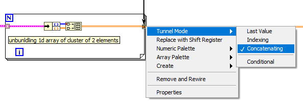

use concatenation

...[time passes]  So it turns out that the fix to your original code is very simple.  Instead of *indexing* your 2D array at the For loop output tunnel, right-click and change it to *concatenate* mode.  That's it!
