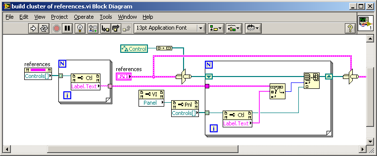

Here's an approach that I think does what you want, although it's not as straightforward as one would like.  Build your cluster of references with the reference names matching the corresponding control labels.
Now, in your subVI that sets up the reference cluster, do as shown in the attached image and subVI (saved in LV 8.5).  Convert the cluster of references into an array.  Create an array of all the cluster element names.  For each front panel control or indicator, search the cluster element name array and use the output as an index into the reference array.  Outside the for loop, convert the array back into the cluster.  This approach ignores any front panel items that do not have a corresponding entry in the cluster.
Message 9 of 11
(5,907 Views)
That's pretty good... I'll use some derivative of this that does the searches from a hard-coded string. I don't want to FORCE a 1-to-1 name relationship between the control and the reference so that if for some reason the control name needs to be aesthetically changed without having to make corresponding changes to the reference names. Good stuff...
