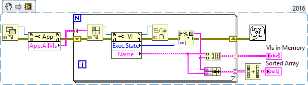

There are several ways to do this, depending on what you want to do.  At one point, I wanted to get a list of all the VIs in memory, as there were some that weren't shutting down properly and I wanted to locate them (so I'd know what to fix) and also programmatically force them to stop.  Here is a little routine that I wrote first that just lists the VIs in memory:
Show All VIs in MemoryShow All VIs in Memory
