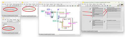

I'm writing some code to programmatically read all FP and BD comments on a VI. This works fine on my test VI, but doesn't work on typedefs. For whatever reason, Traverse for GObjects doesn't see the comment on the FP of the typedef:
Additionally, calling the property VI.Panel.AllObjects doesn't return any references to a comment on the "front panel" of the typedef.

Strangely, that comment is owned not by the front panel, but by the numeric control.
But knowing that hasn't helped me figure out how to get a reference to the comment.

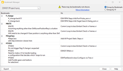

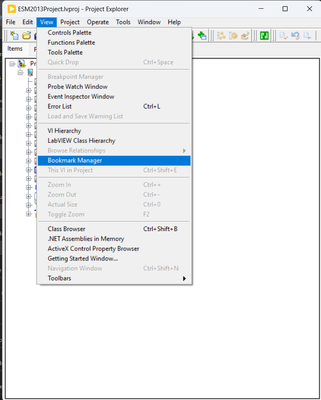

I'm not sure what you are hoping to do with this info, but there is a mechanism that NI has to find comments in your code. They are call bookmarks. If you put a comment on you code and you place a # sign in front it will leave a bookmark. You can then call the bookmark manger and go to those comment later.
Here is how to get to the bookmark manager:
It will open this window so you can navigate back to these later:
not sure if this helps or not but there is a built in mechanism.

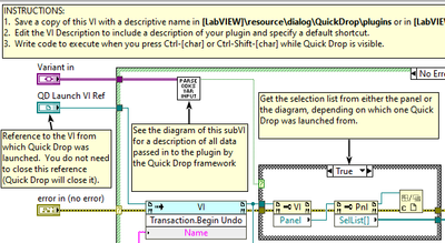

I've only been able to get a reference to it one way and it's not very helpful...
I find that if I make a "Quick Drop" plug-in using the template, and select just the comment label on the typedef's front panel, then the output of the "SelList[]" property does indeed contain a reference to the Text object.
However, attempting to repeat this in a context other than QuickDrop never results in returning that reference.
Best hypothesis I have is that since a "legal" type definition can only have one top-level object on its FP, LabVIEW hides anything else from the execution system when it runs in a normal context.  But when running in the "editor" context that QuickDrop runs in, it allows the extra objects to be seen.

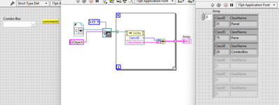

@Yamaeda wrote:
Using a normal Front panel Get all Objects[] or Decorations[] doesn't return the comment (in my test .ctl), so i guess it's not classified as a GObj?
It actually is a perfectly "legal" GObject. If you find its UID (e.g. using a right-click plugin), you can open it using "UID to GObject Reference.vi" and cast it to a Text refnum.
For a .ctl, it appears any free decoration is owned by the firstly created top-level control, instead of the front panel itself.
I guess this allows to have a single object to update when LabVIEW applies the type definition to the instances.
The downside is that the refnum of such decorations is not (easily) accessible, unless you decipher how LabVIEW assigns UIDs to newly created GObjects in the ctl...
Raphaël.

Yes because "Traverse for GObjects" is not perfect and does not find all GObject references, like:
1. "Owned" Text objects:
    - Label
    - Caption
    - Unit Label
    - Editable text fields inside controls/constants
    - Hidden Text objects (like free labels owned by a typedef-ed Control, the frame names label owned by a case structure, ...)
2. Hidden Companion Controls
    - Legend array for graphs
2. Intermediary Panes
    - Owning Pane of Cluster elements
    - Owning Pane of decorations inside a ClusterConstant (yes, cluster constants contain Panes)
