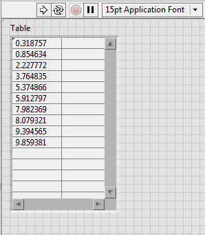

If you want to sort the array before putting it into the table then you can just use a sort array function as shown.table sort.pngtable sort FP.PNG
You can find the sort function in functions palette > programming > Arrays > Sort 1D array.
Let me know if this helps.

Thank you very much it works really well!!! 😄

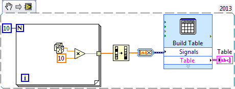

To enter a random value one by one, its possible? (In this, all are entered simultaneously)
Thank you!
(4,807 Views)
Something like this should work for you.
(4,804 Views)

@Miguel_Exe wrote:
I dont find these components :S
Which components?  I just used the Build Array, Random Number (0-1), and Sort 1D Array.  I just stored the array in a shift register, which is just a way to pass data from one iteration of a loop to the next.  You create the shift register by right-clicking on the loop.
(4,778 Views)
Parfait! Thank you very much to the two! 😄
