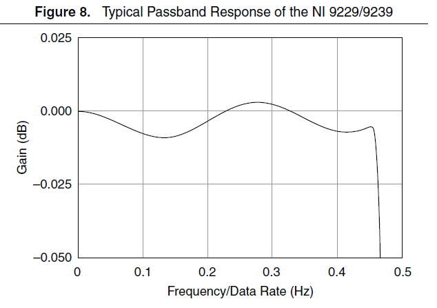

There is filtering in the 9239, I recommend you read the "Understanding NI 9229/9239 Filtering" section of the user manual. I would try to increase the sampling rate (that correspond to the Data Rate in the following picture, also look at the Understanding Data Rates section of the manual) to include more of the signal impair harmonics (the frequency components) in the passband.

Accepted by topic author ritch_by_nature
I don't know details about your cDAQ device, but the "pre-ringing" characteristic of the acquired signal is something I've known to be aware of with DSA (dynamic signal acquisition) devices.   That's the key characteristic barry was referring to also.  Here's a knowledgebase article about it.   Perhaps your cDAQ device has a similar internal bandwith-limiting digital filter?

Son-of-a-gun, it really is a Gibbs phenomenon!  I didn't know this "hidden gotcha" about Sigma-Delta devices (I've mostly dealt with "ordinary" A/D, D/A, and DIO stuff).

Ritch,
     I recommend tagging Kevin's response as the "solution", as it contains a reference to a very cogent explanation that a number of us ("experts"?) missed.
