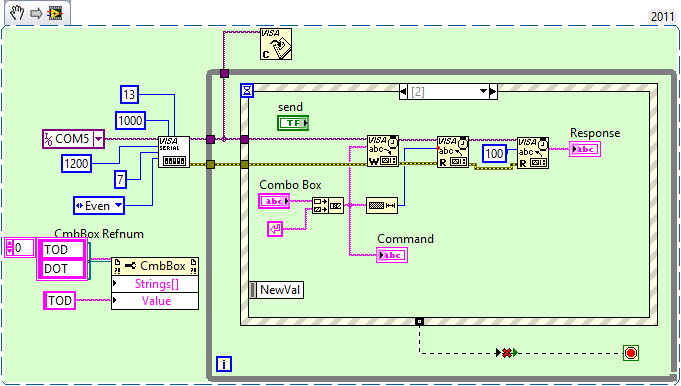

This is an example, assuming that carriage return is the term char (seems that snippet creation was faulty, see the attached vi to view unbroken code).
I'm also assuming that the response is no more than 100 characters long.
