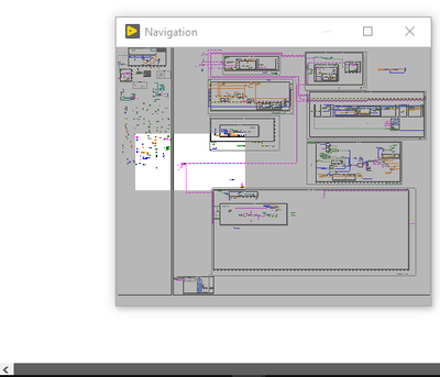

While working on a large block diagram, the VI started to act weirdly: It is not possible to scroll to the far left with the scrollbars, it just stops too short. It is only possible to get to the far left of the diagram with the navigation window, but the view just snaps back when moving in the diagram: See here how the scrollbar is on the far left, but as the navi window shows, the view is not showing the left-most part of the code:

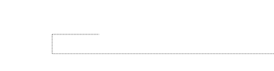

Additionally, when adding a local variable via right click -> create, it is only ~1 pixel wide, only visible when selecting with the marquee tool:
This is how a variable looks right after creation:
After that it's only visible when selecting:
Impossible to wire. The wire just expands to infinity:
It does not matter which variable I choose. This behavior appeared after trying to tidy-up the diagram and de-activating auto-grow (including some diagram-explosions, because auto-grow is really flawed). Is there anything I can do to "reset" the VI or make LabView completely re-compile it?

I think your problem is that your block diagram is simply too big. There is a max size the block diagram can be. I don't recall the exact size but this looks like it is very likely what your problem is. I highly recommend that you start simplifying this code. Put things into subVIs, reduce the complexity of this VI, don't try to do everything in a single VI. You should never have a block diagram this large. It is just not maintainable.

Note that it is not just the "size", but also the position. If your diagram elements are way offset from the center (e.g. near -32768 or 32767 horizontally or vertically), even a smaller diagram can get corrupted.

Thank you both. Through your hints I now understood what happened: While tidying up this huge inherited code, I've accidentally copied a section that contained local variables by ctrl-c/ctrl-v.
This created copies of some front panel elements that LabView randomly placed outside its own boundaries. I was dumb enough to not notice this and continued working + used the clean-up selection tool quite often with auto-grow on in some structures, which resulted in wires to Nirvana and some explosions, thus the code got more and more corrupted.
