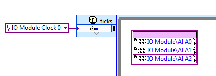

Did you place the AI node in the IO Mod Clock 0 clock domain?
If you don't have those analog input nodes inside of the correct clock domain you'll be performing an unsafe clock crossing that will result in glitching.
The user manual walks you through how to add the IO Module Clock 0 to a project. Or you could start from the getting started example.
