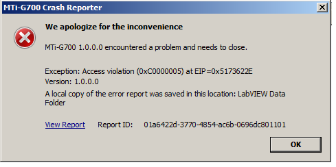

I need a bit more help here.
I successfuly made my app work, everything works without errors.
After I stop the app, I get no errors. I can access the HW the app used without problems from other app.
When I close the VI, once it unloads the DLL, it crashes with access violation.
This happens only, if I "touch" the USB driver functions. If LabView just loads the DLL and unloads, no crash...
This is the debugger output visual studio generates for .exe file:
'MTi-G700.exe': Unloaded 'D:\WORK\C++\Projects\Xsens XDA wrapper\XDA_wrapper\Debug\XDA_wrapper.dll'
'MTi-G700.exe': Unloaded 'C:\Windows\System32\msvcr100d.dll'
'MTi-G700.exe': Unloaded 'D:\WORK\C++\Projects\Xsens XDA wrapper\XDA_wrapper\Debug\xsensdeviceapi32.dll'
First-chance exception at 0x51b4622e in MTi-G700.exe: 0xC0000005: Access violation reading location 0x51b4622e.
Unhandled exception at 0x51b4622e in MTi-G700.exe: 0xC0000005: Access violation reading location 0x51b4622e.
The program '[5848] MTi-G700.exe: Native' has exited with code -1073741819 (0xc0000005).
Please help me, guide me, what might be the cause of this...
So far, the solution I had was to disable the error reporting...
(6,083 Views)
So,
this was caused, by corrupted heap. It woked fine in debug config, once in release, it crashed.
I had some wrong memory management in the dll code.
