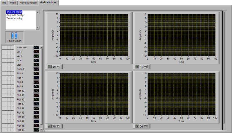

Similar problem... I want to show different data in 4 graphs, but I want allow to user to select it... Maybe there are more plots than shown, for this reason, I need to use the scroll bar. But I need to know the index to show the same index of the 2D array of boolean that makes visible/invisible every plot in every graph.
The legend shown corresponds to a not-visible graph. One solution consist of make a self-legend, using a cluster with the booleans and string with the plot name. But I want to conservate the legend of the graph because I want allow user to change the plot properties (color, etc.) and replicate it tho the other 4 shown graphs...
Any idea or workwaround?
Thanks and regards,
     Jaume

    yes, you are right. The user has to be the ability to select which plots to see in every graph, using the 2D array boolean on the right. If I move the legend of the hiden graph (I use it as "main legend" for all graphs), the 2D array must move solidary, to show the same index of the first element of legend. This is a problem if I don't know which index the legend is showing.
    One possible workaround is program a "custom legend" with an array of clusters that contains name, 4-elements array for visibility, etc. but I loose the "plot configuracion" functionality (color, line width, etc.)
     thanks!

I've attached a very simple VI that uses the Horizontal and Vertical Splitter Bars to divide up the block diagram.  Could you disable the scroll bar on the plot legend itself, expand it fully, and just use the scrollbar of the Vertical Splitter Bar?  This way the whole window will scroll together, and the 2-D array of Booleans will always match up to the correct plot.
Jared R.
Precision DC Product Support Engineer
Message 8 of 18
