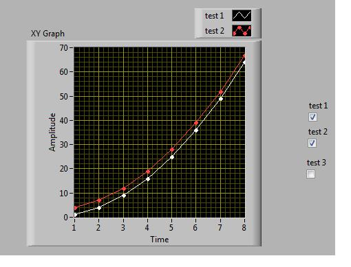

I have a X-Y graph, and I have about 3 questions regarding programmatically changing some features.
I have 3 plots, and under normal circumstances when I plot it I will get something like this:
22645iD26DDFE53D1231D2
1. I will like to change the names of the legend
2. I will like to be able turn on and off the plots, and let the legend adjust size automatically
3. I will like to be able to adjust the plot type/style/color.
I will like to have something of this nature:
22647iF49E2CC7EFCB678B
The active plot is not working for some reasons. The plot name only gives the name of the last string.
Any suggestion will be appreciated
