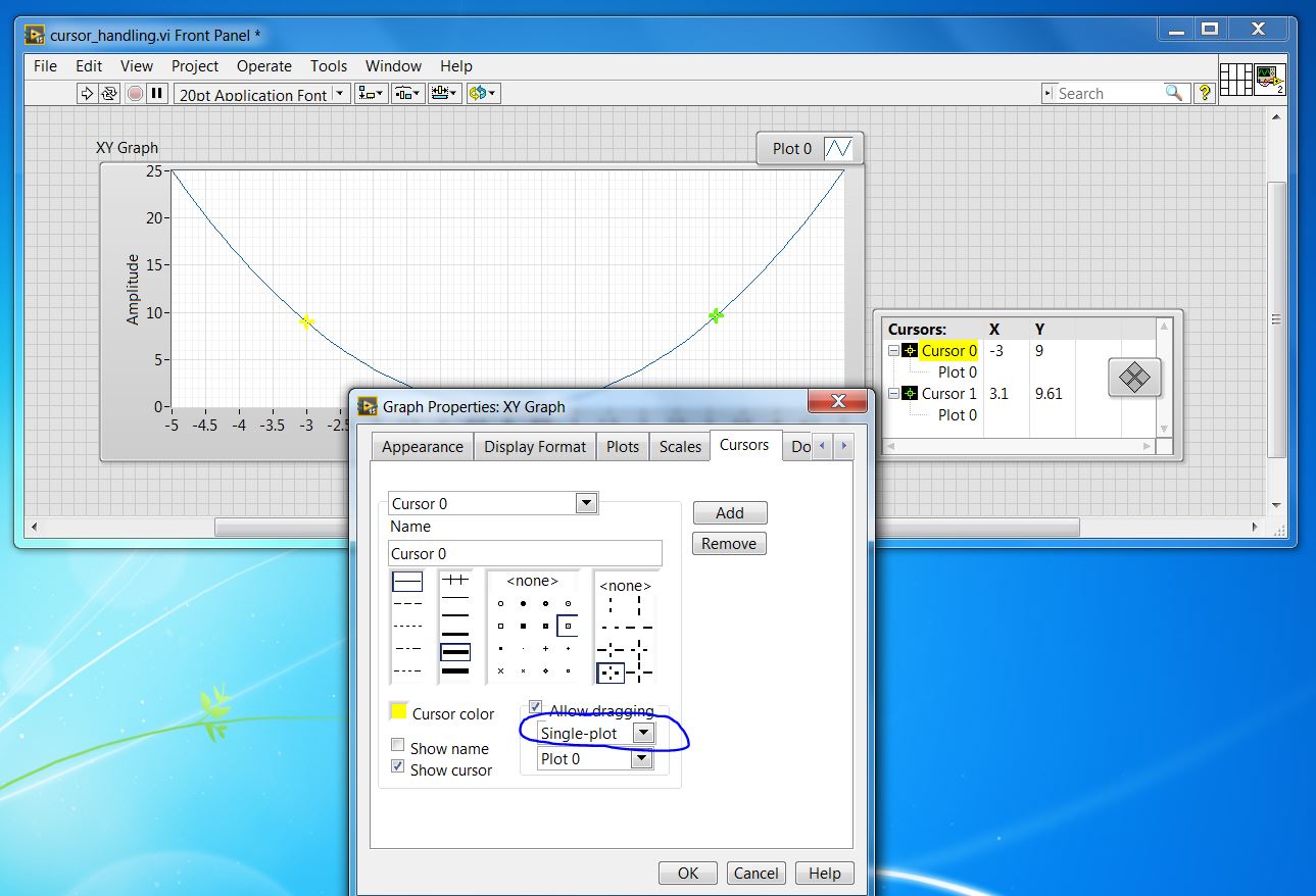

On Front Panel it can be done by specifying "Single plot" option.
But how to do the same programmatically ?

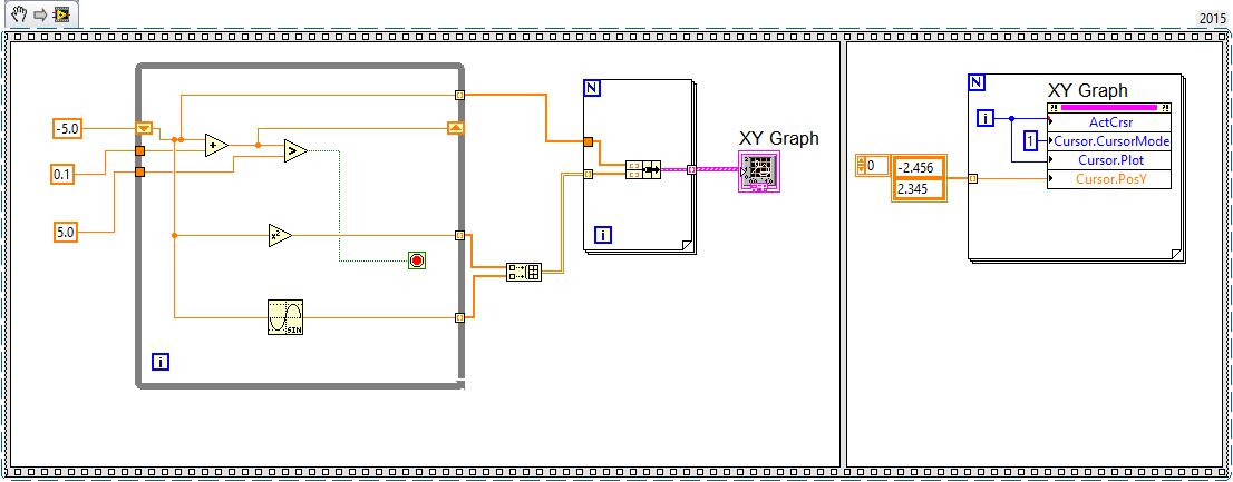

Actually the Cursor.CursorMode does the job (please see the snippet below).
The value 1 corresponds to Single-plot mode (https://www.ni.com/docs/en-US/bundle/labview-api-ref/page/properties-and-methods/vi-server/generic/c...
Also it should precede Cursor.Posx.
If I correctly understood, the Cursor.Plot selects to which plot cursor will be locked.

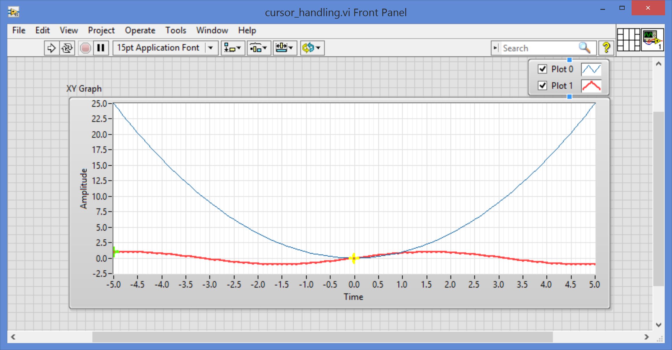

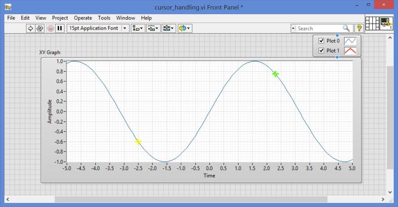

I've tried to check it by adding 2nd plot.
Surprisingly, the 2nd plot is displayed, but 1st is lost (please see screenshot below) !

You are not setting the Cursor.plot, so both cursors go to the same plot.
You are only seeing one plot because you are not autoindexing on the output tunnel of the first FOR loop. Only the plot from the last iteration is currently retained.
Also, once you set the cursor mode (via properties or property node) you don't need to call that property ever again, so why is it even in the loop

Your for loop executes twice, but there is no autoindex on output tunnel and first iteration is useless.

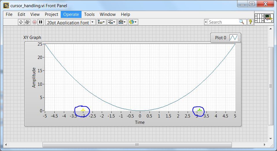

Yes !
Tunneling mode resolves the issue with non-displaying of the 1st curve.
Concerning cursor handling, my results are different from yours (please, see the screenshot below)
