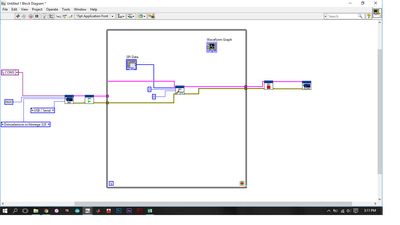

that's the snippet I followed but that's not complete. Honestly, I do not know if that's going to work. Don't mind the Waveform Graph.

The screenshot you posted was way too small to see what you are doing. Post a larger screenshot or upload your VI so we can open it.
You will probably need to modify your Arduino code to output the accelerometer data over serial and then use NI-VISA to read the data in LabVIEW, decode the string containing your accelerometer values and then write them to a waveform chart.
