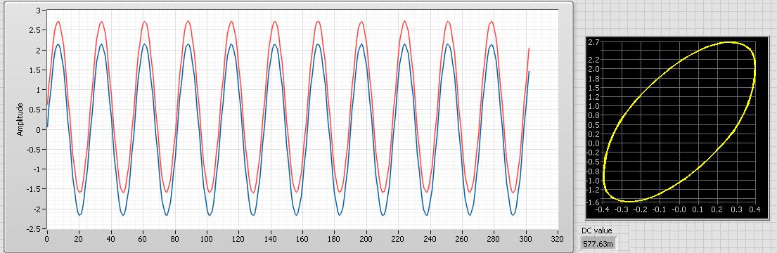

I'm just getting my signal to be clean and centered with the offset. That's all.
Reading the screw terminals with a volt meter gives me 1.07v/+-0.003v. My Fluke multimeter going through an AB switch tells me 1.54v. They're both steady.
This is my graph with these voltages applied.
The red is without the offset applied.
Message 9 of 18
(4,958 Views)
Correction, the measured voltage across the 1Mohm resistor is 1.07, measuring the voltage directly from ai+ and ai- (not including the resistor) is 1.57v.
