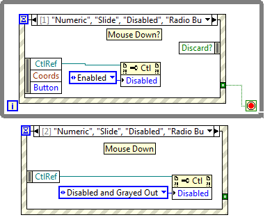

Just as a wild guess, I tried using an Event Structure.  Works better than expected for the slide, enum and system radio buttons.  Interesting behavior for the numeric control, you can use the increment/decrement buttons but can't enter a value directly.
On the one hand, an interesting experiment, on the other hand a word of caution.  One thing that really cheeses me off is non-standard GUI behavior.  Functioning controls which are greyed out fall into that category.
Now that you know how it is done, don't do it (IMO).

In the Mouse Down? event I enable the control and in the Mouse Down event I diable and gray it out.

Darin.  I would have spent days before I tried that approach!  NASTY behavior of the front panel.   I agree the experiment seams to reveal a bit about how the various components of controls are related and is worth some further "playing around" to peek under the hood a bit.
More importantly- I totally agree with your "Don't do this!" caveat.  a user would barf if given a UI that responded that way.
17699iB9F574BBA71397F3
But it works so well!
