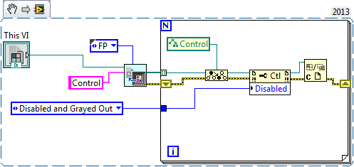

As other have said get the control references and disable.  I like the Traverse Objects to get the references easier.

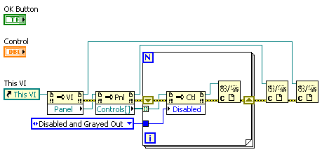

@JÞB wrote:
Yup
Jeff, any benifits with merging the error lines in parallel like your example? as oppose to ...

Is it even necessary to have the Close Reference functions on this?  I thought this is one of those cases where the references are already in existence because the controls are in the VI, and they would be self closing when the VI leaves memory.

Apok, Bill
Its merely a style issue.  No specific benefit.  Bill is absolutly right that these refs will be cleaned up without the close ref.  In fact, In theory if the Panes[] PN returns an error the loop will not iterate and all of the lower three errors are identical.  So WHY? because, the guy in the next cube may be working with property nodes of some other class. Almost garunteed to be interfacing to some .NET assembly written by the maestro of poor programming practice, known affectionatly to us as "The manager".  Now I have to explain to him/her why your adaptation blows up but my code is safe and maybe, even point out that the richly obfuscated assembly from the manager was concieved with all the talent our worst intern could have outcoded in diapers.   Now they are confussed and remember that my code doen't follow the standard I enforce on them "Just because I think I'm Mr. LabVIEW Trivia buff."  So, the coworkers begin to hate me just a little and, the manager thinks I hate them (I might but, I woudn't want them to think so.)
I guess that actually is a specific benefit 😄
