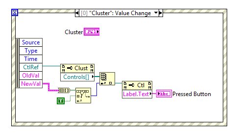

Kind of. You can put them all in a cluster. If only one of them can be pushed at a time, then you just need to look for the true value. Otherwise you will need a little more thoughtful logic to figure out which button was pressed.

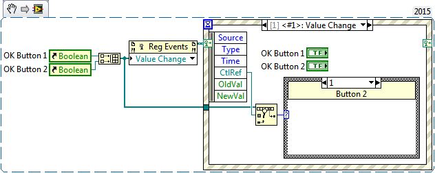

You can also use dynamically registered events, then all you have to do is add another reference to the array:

Cluster has value change event and "controls" property to get reference of hte actually pressed button.

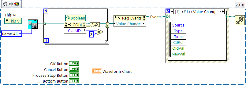

Ideas that were previously stated with some mods. Traverse for all booleans, then dynamically register. Have a default case that does nothing in case you want to action to occur with a boolean.

The traverse VI finds all the booleans in the VI. You could do some filtering if you wanted after this step if you wanted, for example to eliminate indicators.
The traverse VI returns an array of references, you use this array to dynamically register for events, such as value change. When one of the value changes, use the control reference in the event structure to read the label of boolean. Use this label as a case structure to decide what to do next for a particular button.
What is nice about the traverse VI is you do not need to create an array of references, it finds them for you.
