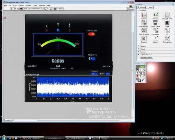

OK guys i got this tuner finished!! thanks so much for the advice! here is a picture of the front panel guitar tuner

Your picture was missing
