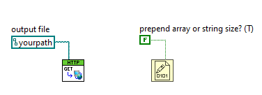

Hello everyone! I'm trying to use the GET HTTP.VI to get a binary file from my firebase storage, but the file doesn't return the same. The GET are changing some inicial bytes.

Written this way, the first four bytes in the file will be the string length as an int32 be.
Either wire a path to the "output file" input of GET.vi or wire false to the "prepend string size" input of the write binary file node.

Thank you, cordm! Now is working perfectly.
