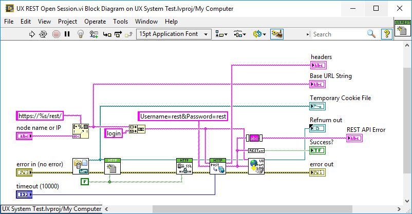

I had an HTTP VIs that use to work in LabVIEW.  Recently, permissions changed on the APIs on the server that I was connecting to. The permissions has now been fix. But still my code does not work.  I have used postman to send the same commands and they work fine.  See my attached picture.
It shows error 400.

Your 'headers' you are sending are malformed.
The 'add header' VI adds a key/value pair to the HTTP header. You are building the key value pairs yourself instead of letting the VI do them for you. You should call the 'add header' VI for each key/value header pair you want to send.
To do the authorisation, you just need to put 'Authorization' into the 'header' control and then your 'Basic **password**' as the value. That will add a line "Authorization: Basic **password" to the headers. The HTTP Client VI handles the other headers automatically itself (e.g. the timestamp).

FYI, your solution in separating headers to "Add Header vi" worked.
Now I am curious as to why it worked before and now I have to code it as you suggested?
