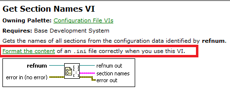

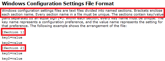

Here's the documentation for the VI in LabVIEW 2015. You mentioned using LabVIEW 2015 SP1, which hasn't shipped yet, so I can't speak to its documentation, although I assume it is the same as the screenshots below:
Clicking the link gives you:
You mentioned using a "regular INI file". If "regular" in your case means an INI file with some or all of its contents not under a named section, I would not expect it to behave the way you desire, per the documentation.
