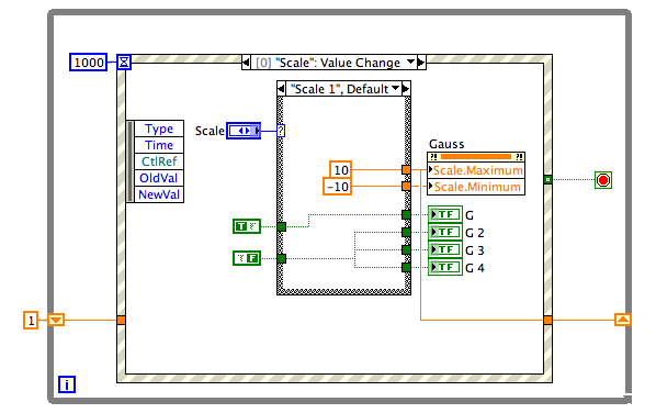

I am not sure I follow your question.  Are you saying that the measurement always produces, for example, +/-1 V full scale regardless of the range?
If so, two ways of changing your displays.  One is to multiply the data coming out of the DAQ Assistant by a scaling constant before passing it to the displays.  The other is to "fake" the display scales.  The display would always be +/- 1 internally, but the scale markers would be changed.  The latter approach is rather complicated to implement, so I would recommend the former.
In the Scale: Value Change cases add a constant To multiply the data.  It might already be the Scale.Maximum value.  Pass this value via a shift register to the displays in the timeout event case.
Lynn
Message 16 of 35
(2,087 Views)
Yes,that's what i want to do.In each of the 4 different scales,i want to multiply my DAQ assisant output data with a different constant every time in each scale. But if i put it the timeout event case,it's the same multiplier for each scale.I want it to be different.So my really rookie question is how to change my multiplier for each scale...(Excuse me Lynn for my many questions!I can assure you it's the last one!Or i hope so..)
Message 17 of 35
(2,066 Views)
Here is a chance to learn about an important LV tool: the shift register.  The images below show how to modify the program I posted earlier.  Follow the directions in my previous post.
Lynn
Message 18 of 35
(2,060 Views)
It's done!!Thanks a lot Lynn!!Smiley Very Happy
