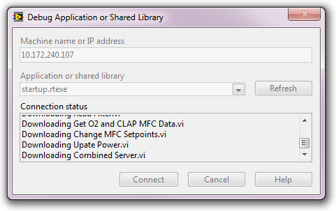

Hello all,
I am attempting to debug an RT application running on a PXI chassis and I am getting some frustrating behavior when I go to debug the executable using the Operate->Debug Application or Shared Library functionality.  Essentially in the Connection Status text box, the status runs through all the components (Downloading...) until it get to the main application itself and then just hangs.  I can not cancel and it never seems to connect (see image).  Does anyone have any thoughts?  I have some behavior that is occurring only when running my executable so I need to be able to see what is happening.
Thanks, Matt

I am seeing this behaviour on an application that I have built that is intended to be used on another PC.
I understand as margasan suggests that disabling portions until finding the culprit is probably the only recourse, however this is certainly annoying when the build time for my application is >5 minutes...

Hello Mart,
(I generally go by Matt 😉 )
Yes, other executables seem to be ok - this appears to have something to do with the size.  My problem is not necessarily that it has trouble connecting, but that I have no recourse when the system does not return properly other than to shut down LV through the Windows Task Manager.
Regarding the suggestion - I understand where this is coming from and have done this when executable builds have failed altogether, but this seems about the equivalent of attempting to debug code using print "Here I am" statements peppered throughout. This is an excruciating way of attempting to solve this problem with large applications (cut code, build, download, attempt to connect, reboot LV, repeat cycle); surely NI has a better suggestion?  Are the engineers there familiar with this problem?  Should this be a CAR?  Am I the only one who has experienced this?
Cheers, Matt
