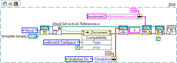

I'm having a weird problem. I'm trying to write an underlined    X    in a bookmark in word. I have 4 spaces before and after the X. at one location the program writes what I want exactly but at another location is ignores the last 4 spaces. If I write letters instead of spaces, it would write it. The code is attached along with the result. I need your help so please take a look.

You will find the answer here. I don't think there is a way to do this programmatically. You can avoid the issue if you use tab instead of spaces.

It can be set programmatically, here's how to do it:

That worked perfectly. Thank you so much
Ben64
This works as well. Thanks again
