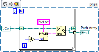

In all the excitement, I'm not sure anyone addressed the question that SoIPS raised, namely how to deal with nested folders and files.
Here is a little demo that illustrates how file and folder nesting work.  It starts with a root path, C:\, then appends "1.txt", "2.txt", etc., saving the growing path in Path Array.
The important point is that the final "filename", say "4.txt", is treated as a file name, while the preceding part of the path, say "C:\1.txt\2.txt\3.txt" is (automatically) treated as the Folder name.  Whatever you wire into Build Path as "Folder" (whether it is a string or a folder) will be considered a folder path, and whatever (string) you wire into File becomes the Filename, with LabVIEW automatically adding the backslash separator.
Think about how this works, then rewrite your own code to "do what you want it to do, not what you told it to do".

Thanks everyone for all your responses. Matter of fact, I fgured out what I was doing wrong yesterday.  Wiring the ouput of the build path VI will create a file as opposed to wiring to the output of the create folder VI.  This VI that I attached is actually a subvi of my report generation VI which creates an excel file test report. The excel file is always created before this subvi is called.  Thanks again everyone for your input.
