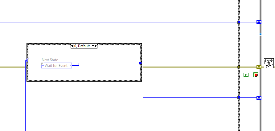

Hi kias3399,
I can understand your question. You're asking why the program is not turning to "User State 1" case from the "Wait for Event" case after you click 2+3= button right?
Well from the code that you've sent, there are a few broken wires in both cases. In the "Wait for Event", make sure you remove the next state enum indicator and try to rewire the enum to the shift register as below
And in the "User State 1" case, I recommend you to delete the enum indicator and rewire again as below:
There are still so much thing to do by your own to complete this program, but for this forum topic, this I so far that I can help.
Thank you.
(3,702 Views)
@Sogekking091 wrote:
Hi kias3399,
Where did you see broken wires?  I didn't see any.  The VI was broken because the typedef for the enum wasn't attached, but beyond that, no broken wires.
(3,699 Views)
My bad, almost forgot about that though. You're right!
(3,697 Views)
