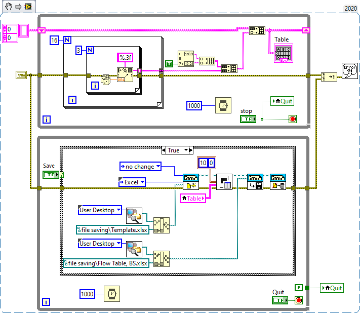

Sorry for the delay, but I didn't have LabVIEW 2020 installed yet, so I installed it on a VM (I'll need it, eventually ...).
I made a few simplifications of your code, including saving your data in chronological order (earliest first, rather than latest first), and didn't try to do multiple Saves (after I pushed "Save", I pushed "Stop").  I also added a Stop button (and a second "Quit" button to stop the Save loop).
I simplified the generation of 16 simulated data triplets by using a nested For loop, and used a Shift Register to hold the growing Table.
When I ran this, I got a very nicely-formatted output, Flow Table, BS.xlsx, which I've attached.  Here's a Snippet of my version of your code (note that I placed your file on my Desktop, hence the revised building of the File Paths.  I noticed that some of your Excel files were Password-protected -- I have no idea if that will cause problems with LabVIEW, but I had no trouble with the code I've attached ...
Bob Schor
