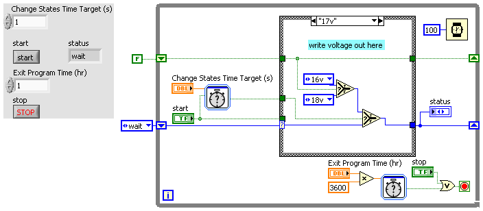

a little code to get you started... Smiley Wink
ofcourse, this is stepping the voltage only and not ramping it....
Message 5 of 8
(8,791 Views)
Thank you so much man. I'll still need to make the program to commincate with the power supply, but at least that's one big hurdle out of my way 🙂
