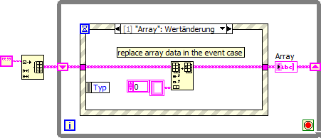

When I first run, I want to select and show the entire data to the array, and then the user will search and show the selected data!
Is there any way you can combine the two arrays in the picture?
Yes!
Wire the "array" data through the event structure and place the "array" indidcator after the event structure. Now you can use a TimeOut event case to show "first" data, and you can replace the array data inside the "Search" event case…
(This is basic DATAFLOW programming!)

Hi adavb,
example:
The shift register holds the array data, and you can manipulate that data in the event case(s)…

Thanks!! My bro
Thanks you very much!!
