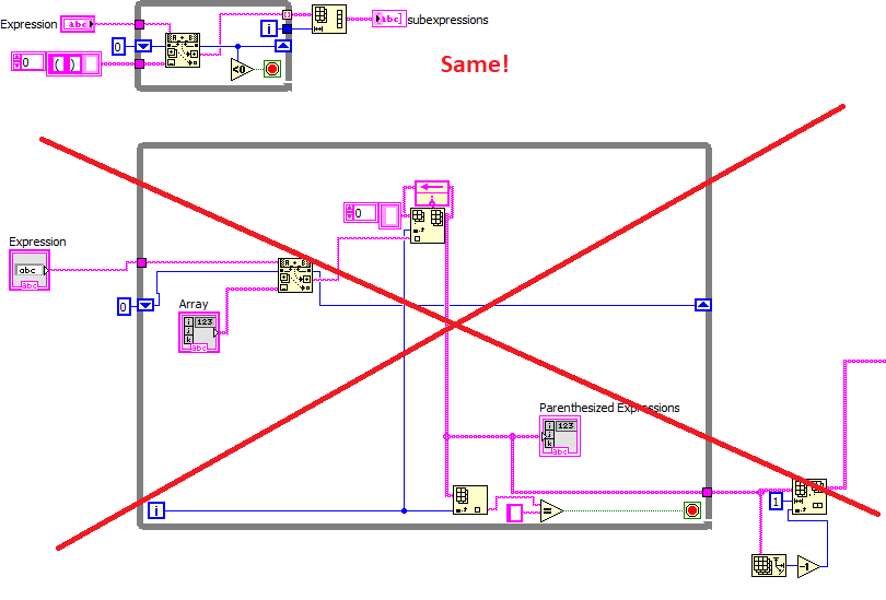

On a side note, your while loop seems overly complicated. This does exactly the same thing:
(Of course this is not quite bulletproof because it does not deal correctly with mismatched or stacked parenthesis).

You could even use a conditional tunnel for even less code:
