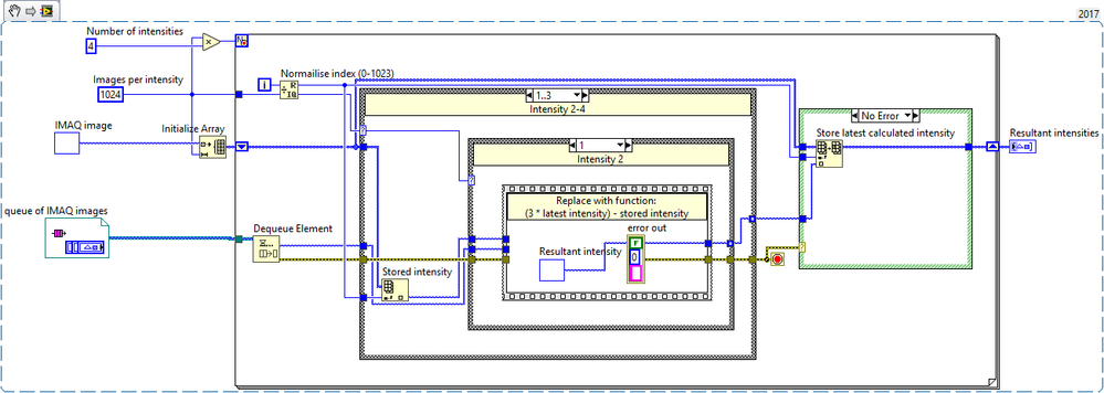

Attached is how I might handle the array side of things. I don't have access to IMAQ images, so I've used a 2D picture as a placeholder. Same with the intensity calculation functions (placeholder only).
Edit: Missed an index off.
Message 5 of 14

My original post has a 2010 version attached as well (Update array LV10.vi).
