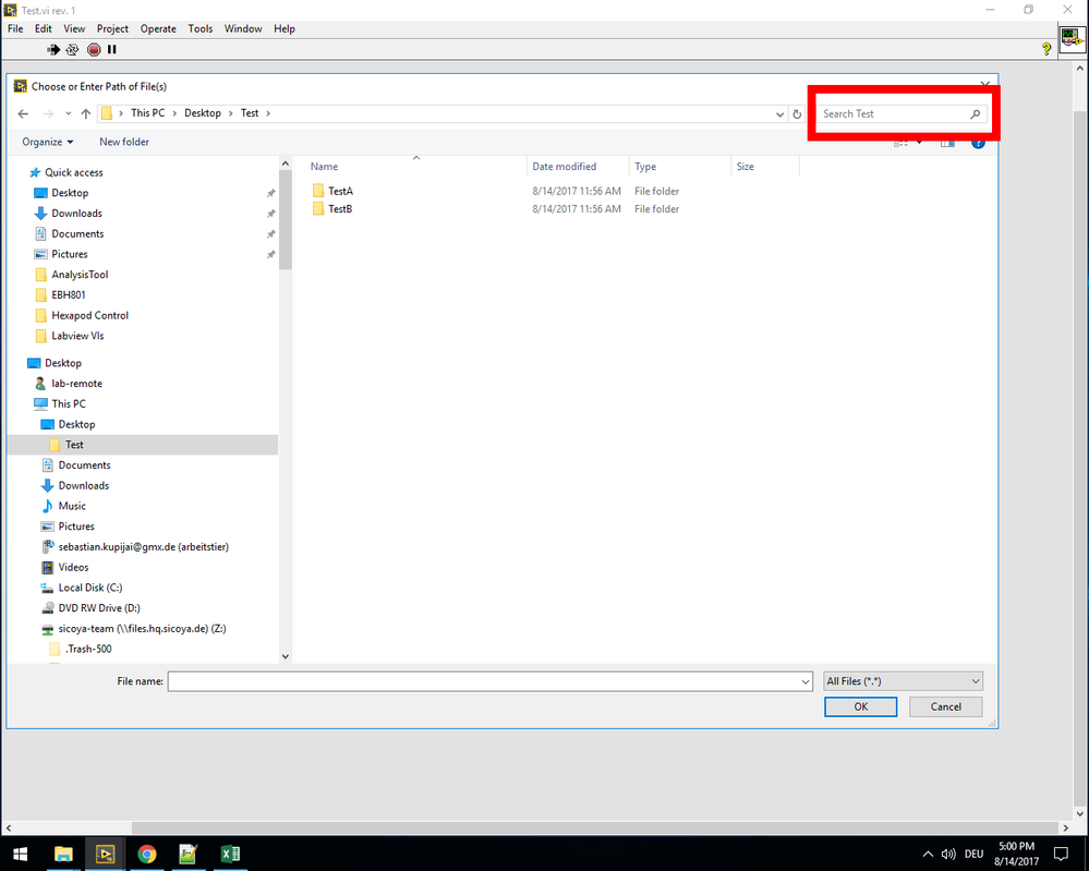

what i mean by "search function" is the possibility to search for files in that dialog box (see attached screenshot).

Okay.  I see what you mean now.
It never occurred to me to ever do a search while using a file dialog in any program, or if it did, I'm never using it to open multiple files.
It looks like the problem occurs at the File Dialog primitive at the heart of the express VI.  (If you right click and pick "Open Front Panel", you can see the underlying code.".
I think this should probably qualify as a bug.  I see it in LV 2017.  Yours is LV 16.  I don't know if it has existed longer than that.
