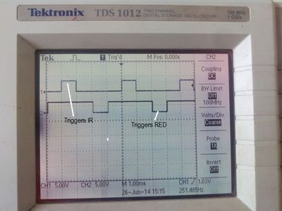

YES you are right, 1 mSec pulse, every 10 mSec.
Above figure shows the trigger pulses generated using standard hardware. One triggers IR and other triggers RED. In above case  I had kept repetation rate 4msec

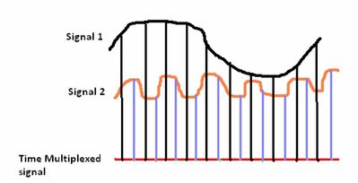

This is the signal which I may get
Now how do I separate both of these signals in LabVIEW
(3,966 Views)
I'm still not clear - your pic shows two distinct signals, yet you're asking how to separate them.
Is there some hardware piece that is multiplexing them?
Can you bypass that?
